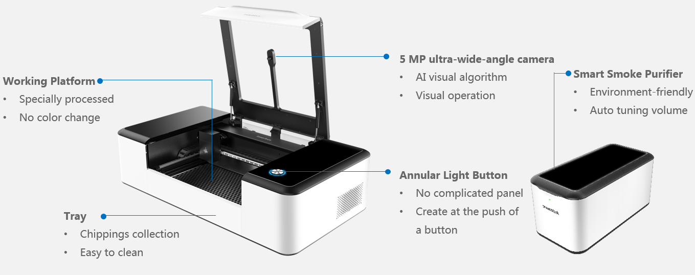

Specially designed for education and creation, Laserbox reimagines and redefines laser operating performance by the use of a high-resolution ultra-wide-angle camera together with AI visual algorithm.
Laerbox
Make Ideas Happen
Bring sketch to Life | Easy to Use | Gallery and Lessons | Safe and Eco-friendly
Auto-identify any official material and then set up the cutting-engraving parameters accordingly. Being a revolutionary laser machine defining operation through hand-drawing, Laserbox makes laser creation easy and fun!
working with lasers made simple
Featuring the AI visual algorithm, Laserbox can follow the pattern drawn on the piece of material and programme the laser pathway automatically, and no operating software required! Just cut or engrave at the click of a button!
Laserbox can process dozens of different materials, including paper, corrugated paper, wood, acrylic, cloth, leather, base plate, ABS-based color board, PET, rubber, glass fiber, plastic, corian, and etc.
Personalised design, save time for creativity
Say goodbye to complicated focusing procedures, no need to adjust the laser head manually. Laserbox has three easy autofocus modes achieving optimal focus.You can also use Laserbox’s software to set up a parameter library for commonly used materials. The next time you use the same material, you can auto-select the appropriate parameters for cutting or engraving.
Smart smoke purifier
The smart smoke purifier automatically opens, and adjusts the volume according to the working status of Laserbox, which ensures eco-friendly ventilation. The filter for smoke purifier could be easily replaced.
Early-warning system
Monitored in real time by collective high-performance sensors, Laserbox has multiple safety notifications, that immediately alert you to issues like overheating and water cooling system errors.
Safety certification
Laserbox has CE, FCC and FDA certificates. The laser has been classified as Class 1 laser by FDA, which is non-hazardous.
